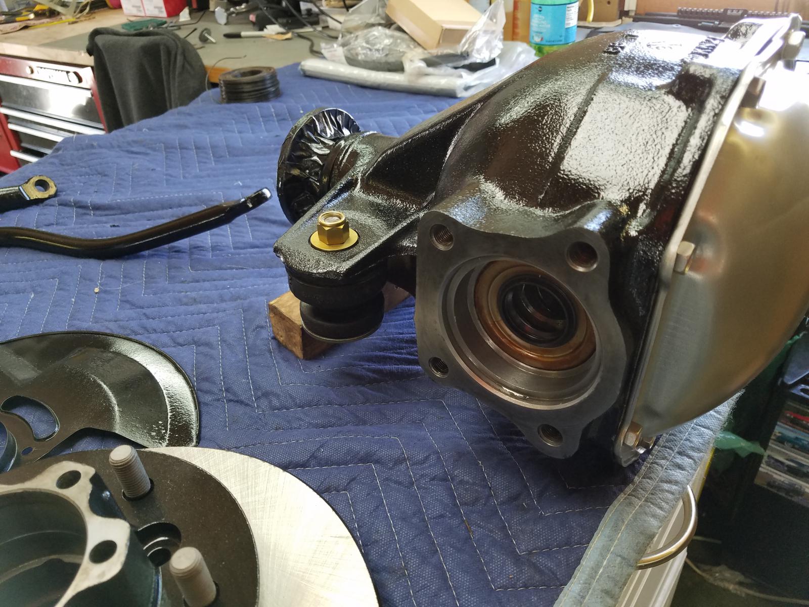

    The Front Diff
    The Front diff is all refurbished now. I finished the painting and went on to install the new seals. The installation was pretty straightforward. I had bought a generic seal install kit which made the job easier.
    Once the CV extension was done I moved on to the diff itself
    The Diff as it sits now. I still have to work on the hardware and CV axles before I completely reassemble.

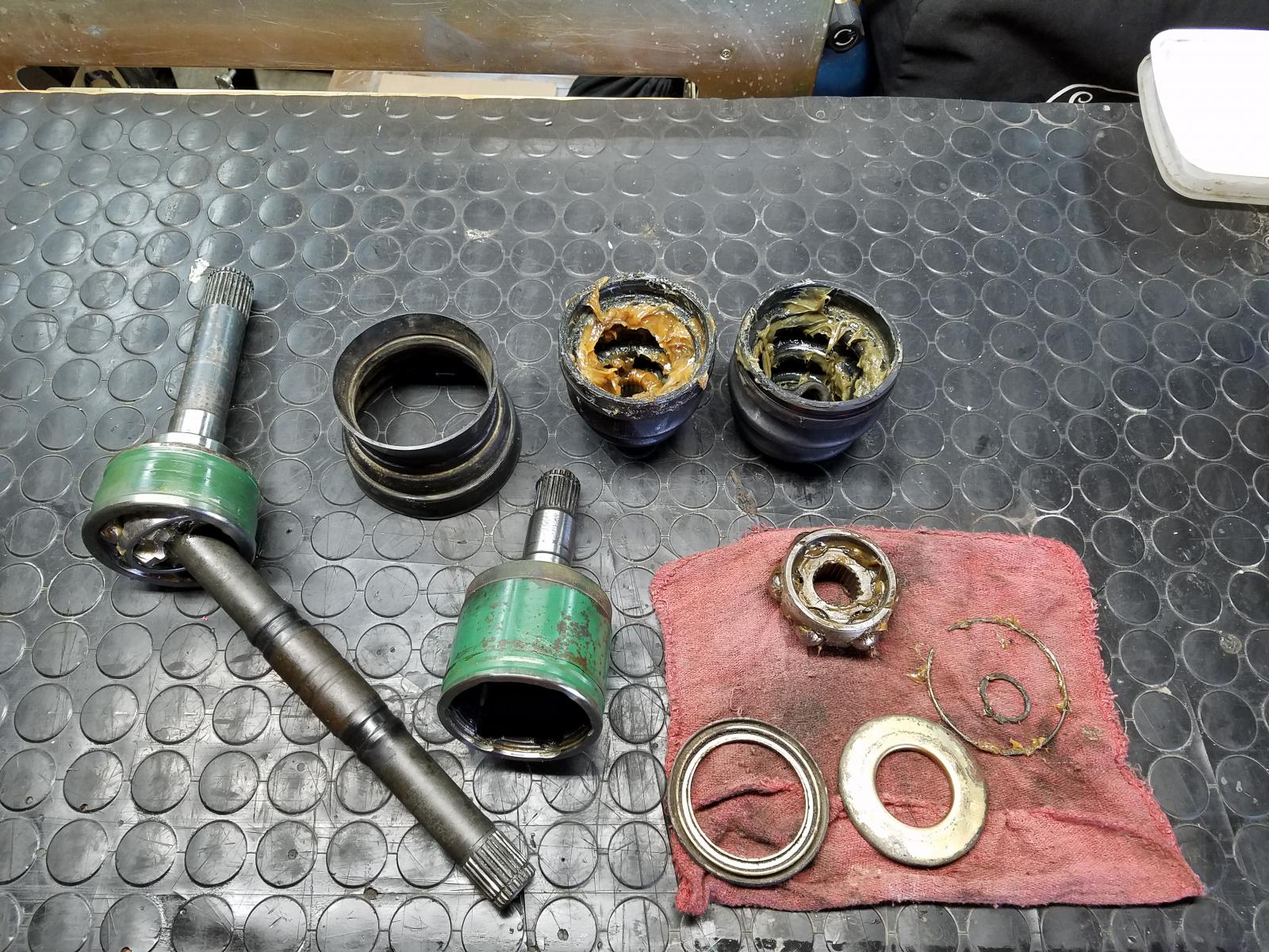

    The CV Joints
    Started replacing the boots on the CV Joints. So far the tear down has revealed no surprises other that the cage and bearings look like they were never used. The boots weren't torn, but they were cracked from time so like everything else on this...while I am there...

    CV Joints Pt 2
    Now that the CV ends were stripped and repainted it was time to get them assembled.
    I bought the wheel side kit from Mitsubishi, and the Diff side is an aftermarket brand from Japan (very well made) that saved me a few dollars. The Mistu kit came will all the bands, clips and grease needed to do both sides of the CV Joint.
    The first part was to get the wheel side boot on and lube up the bearings. Then use the remainder to fill up the boot.
    Once that was done, it was on to the straps. The factory ones are preset so it is just a matter of bending the band over and cinching it down-super easy to do.
    With the Wheel side done it was to the Diff side. First I needed to grease up the race and bearing retainer, then reinsert the balls and grease them up, packing the assembly with more grease.
    Then on to filling the CV housing with some Grease followed by inserting the assembly into the housing and using up the rest of the grease.
    Finally the outer cover for the wheel side boot and the dust rings.
    And finished!
    Since the passenger side is basically the same, I'll forgo the step-by-set and just show the finished product when done. That's it for now.

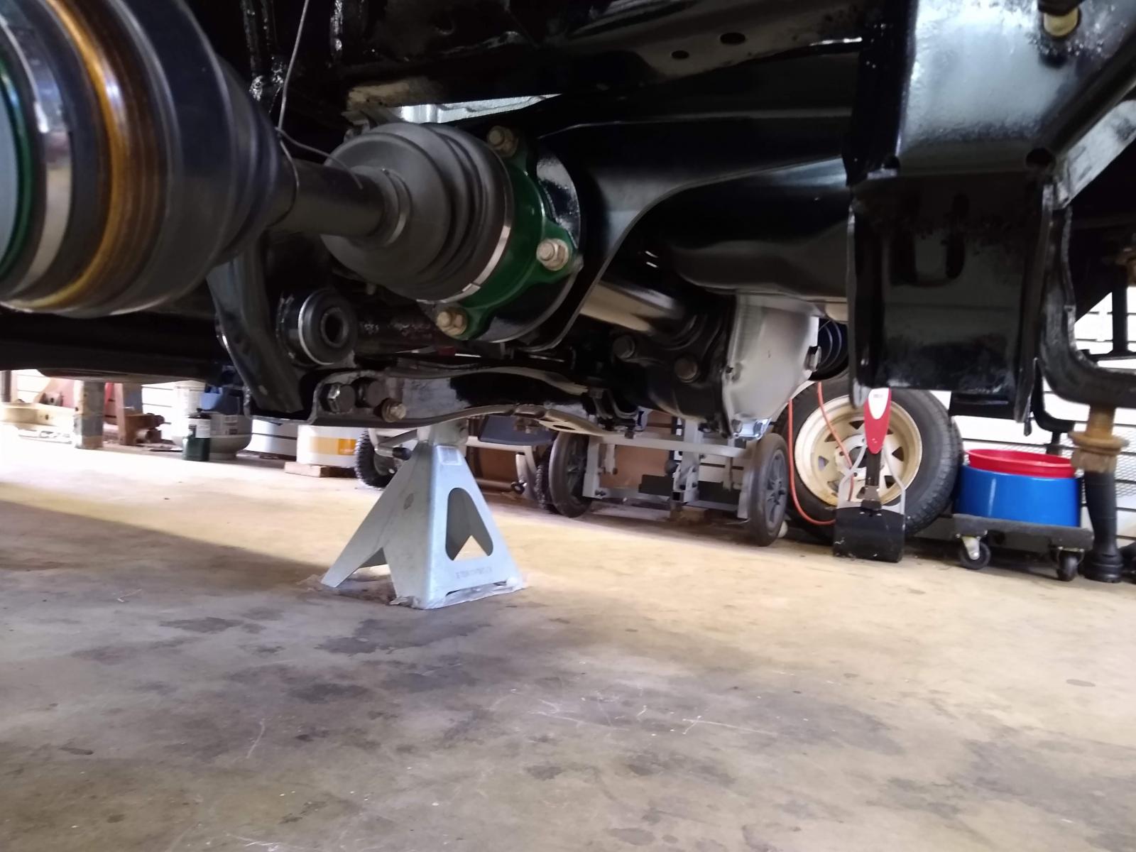

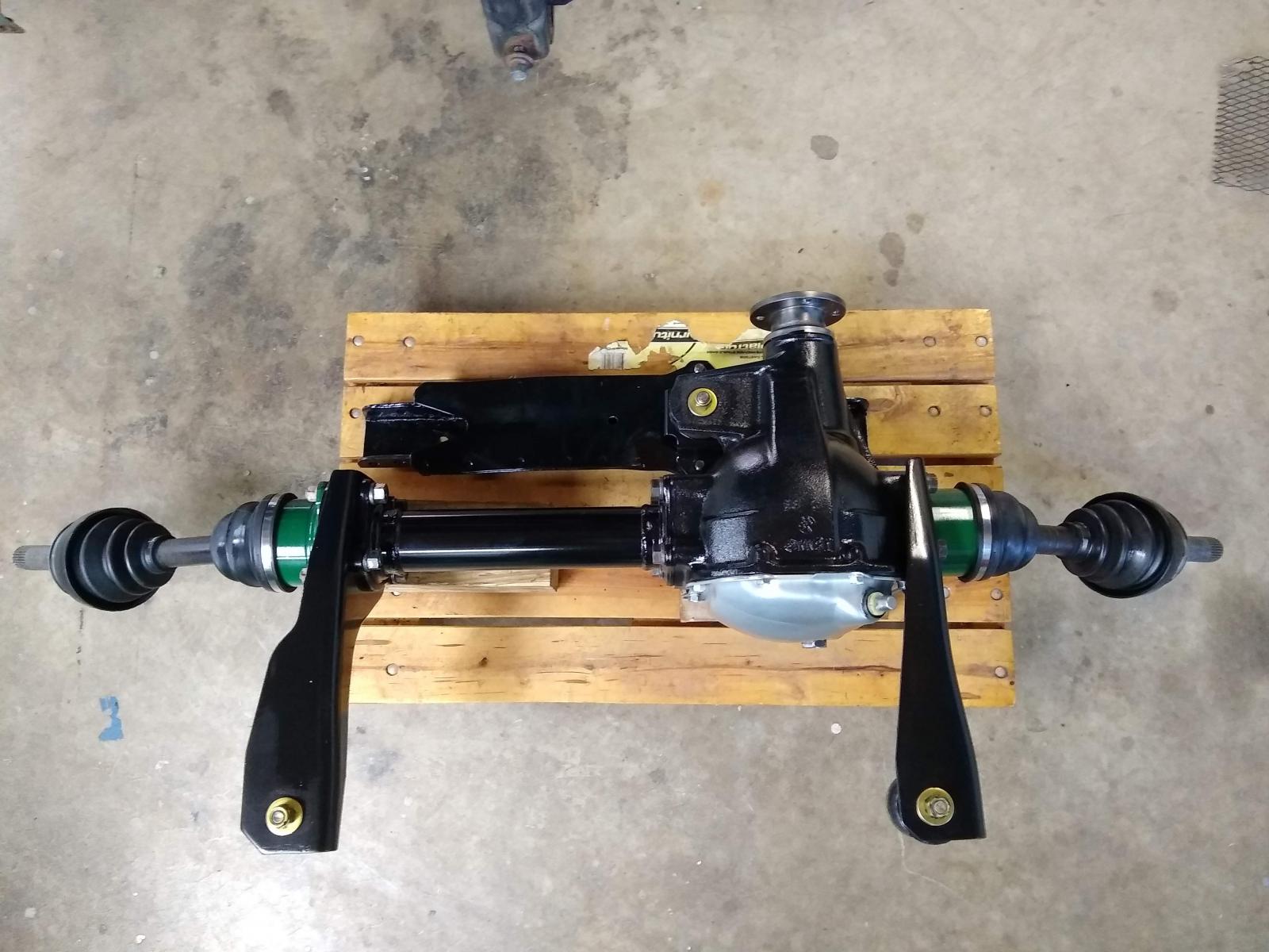

    assembly and mounting of front Diff
    Finally got all the components finished to assemble the front differential, Now on to assembly:
    How it looks assembled:
    Choose to fill it with synthetic GL5:
    The mounting turned out to be more of a chore than I expected, and I dropped the assembly on my wrist while trying to shoehorn it back in place. luckily I didn't break any bones, but my wrist has swollen and a bruise is forming - I am sure I will be in pain for a few days. But, with the help of my jack I got it back up in there and fastened down.
    I've got to work on my Suzuki Samurai this weekend, so I probably won't get back to this for a week or so.
