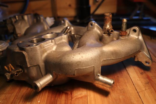

    Does anyone know what connections get blocked off and removed from the intake manifold? I took a picture with everything still attached to it. Someone please edit the picture in an image editing program, like in paint and circle what needs to be removed or blocked. Thank you.
    More close up pictures of the intake manifold with it's various components attached to it.

    You can either remove the EGR valve solenoid and fit a blanking plate over it (easy to make) or just leave it in place with the vac hoses disconnected. The Christmas tree vacuum barb on the manifold needs to be removed and a threaded bung screwed into there. The water barb connection for the heater return and carb choke should be removed and a single upright barb installed (the original barb will most likely be paper thin from rust anyway) The rest of the vacuum connections are only vac thermo switches and pose no risk to vacuum leaks but you could delete them for appearances sake.
    I went a little nuts with mine and completely cut off the EGR gallery running around the manifold plenum and sculpted the manifold. Mine was easier to do as it was off a Gen1 G63B and didn't have a lot of emissions control ancillaries on it and didn't have jet valves either (I had to prepare the manifold for repairs anyway as the water jacket cover plate under the plenum had corroded out and had a few pin holes in it). I capped off the gas gallery that runs through the head into that EGR gallery and ran a metric thread tap through the coolant port that is located on the carb mounting face/seat and installed a grub screw in there to seal it off. Not entirely necessary but reduces the risk of coolant somehow backing up into the plenum if the carb install kit manages to develop a leak.
    Okay, like this right? Am I missing something?:

    Nope. Nailed it There is quite a considerable difference in the intake runner length between the early and the updated intake manifolds. Wonder if there was much of a difference in overall torque as a result...
    Thank you, I wonder though, isn't some of the sensors on the intake manifold used to measure the engine temperature? Check this out: https://www.rockauto.com/en/catalog/...+/+sensor,4748
    The sensor looks quite identical to the picture I posted above. I suppose things did change a bit from the 1st gen.
