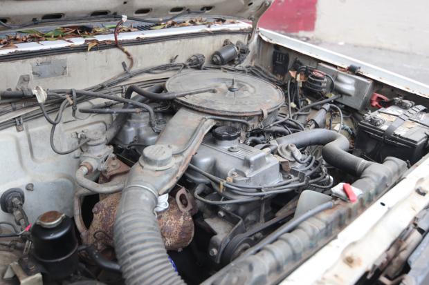

    What do I need to do to replace the Mikuni carburetor to a Weber carburetor? I have a 1988 Mitsubishi Mighty Max 2.6l 4x4 manual transmission pick up truck.
    UPDATE: 11:48 A.M. 6/16/2019 Sunday
    I purchased the Weber 32/26 DGEV K610 carburetor from Carbs Unlimited and received it a few days later. Although, the carburetor has DGAV stamped on the base instead of what I believe is supposed to be DGEV. Anyone know why that is? I took multiple pictures of what you will get when you order the Weber 32/36 DGEV K610 carburetor.
    I received this box that was in another box(inception :
    Attachment 22818
    Overall contents of package:
    Attachment 22819
    Contents laid out on table:
    Attachment 22820
    Pictures taken of the carburetor body:
    Attachment 22824Attachment 22826Attachment 22827
    Attachment 22828Attachment 22829Attachment 22830
    Attachment 22831Attachment 22832Attachment 22833
    Attachment 22834
    UPDATE: 11:18 P.M. 8/11/2019 Sunday
    The following pictures are the components you will receive with the k610 conversion kit. I took a picture of each component to show a closer view.
    Attachment 23103 Attachment 23104Attachment 23105Attachment 23106Attachment 23107Attachment 23108Attachment 23109Attachment 23110Attachment 23111Attachment 23112Attachment 23113Attachment 23114Attachment 23115Attachment 23116Attachment 23117Attachment 23118Attachment 23119Attachment 23120Attachment 23121Attachment 23122Attachment 23127Attachment 23123Attachment 23124Attachment 23125Attachment 23126
    The first three pictures were taken before the conversion started:
    Attachment 23128 Attachment 23129Attachment 23130
    These next pictures, I started removing...
    Attachment 23131Attachment 23132Attachment 23133Attachment 23134Attachment 23135Attachment 23136Attachment 23137Attachment 23138Attachment 23139Attachment 23140Attachment 23141Attachment 23142Attachment 23143Attachment 23144Attachment 23145Attachment 23147Attachment 23148Attachment 23149Attachment 23150Attachment 23151Attachment 23152
    Carburetor removed with it's annoying vacuum hoses:
    Attachment 23146
    Helpful Links:
    Where I ordered the Weber 32/36 DGEV K610 Carburetor:
    http://www.carburetion.com/Products/ProductDetails.aspx?Part=K610
    Weber 32/36 DGEV K610 Carburetor Diagram:
    http://www.carburetion.com/diags/3236DGAVDiaginfo.asp
    Identifying a Fake Weber Carburetor:
    http://genuineweber.blogspot.com/
    Redline Weber Contact Information:
    http://www.redlineweber.com/contactus.html
    What DGAV, DGEV, etc... means:
    https://motofaction.org/mechanical-1...l-differences/
    I call bullshit !!! where is the picture of the weber mounted to the intake manifold???? & running.

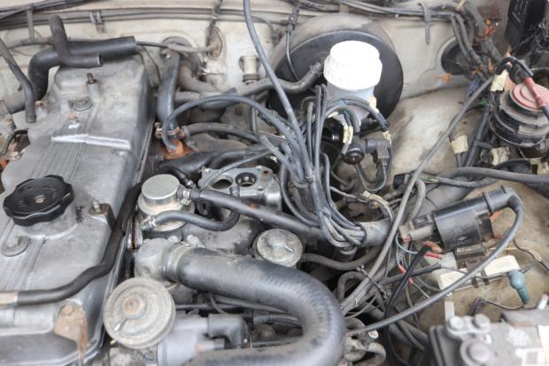

    I finally have a bit of free time to work on the truck. I had some questions regarding the fuel hoses though. There is two fuel hoses as you can see in the following picture:
    What do I do with them? I know one connects to the carburetor, but what about the other one. Also, which fuel hose connects to the carburetor? One is skinner than the other.
  18. #68
    1,246
    None of that looks familiar to me but I know on the first gen there is a fuel return line from the OE pump. Look at the fuel system diagram in the manual it should tell you. When I added the electric pump I blocked off the hard fuel return line with a silicon cap in the engine bay where the hose from the pump connected to it.
