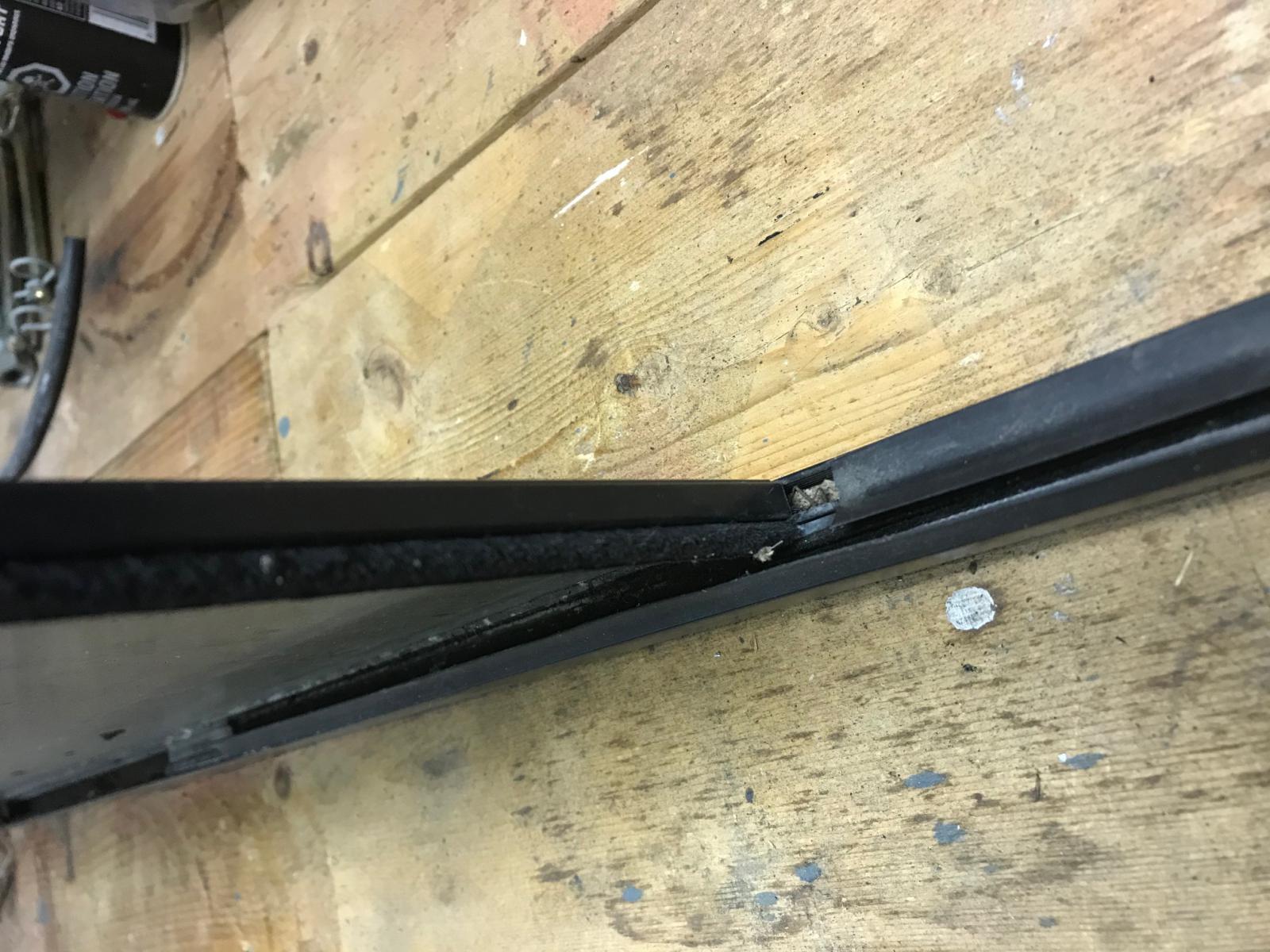

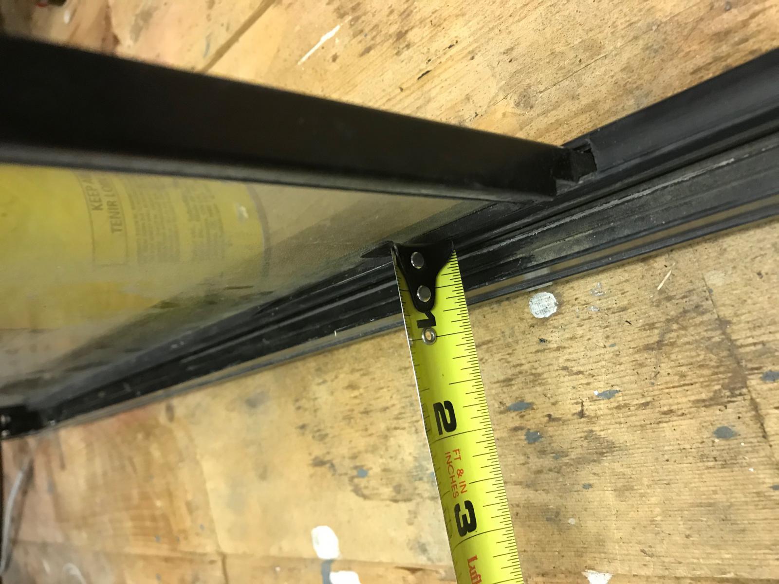

    I took some pics of both windows and the slider panels. The first five pics are of the window I ordered from the salvage yard. I put the measuring tape in so you can compare to the original that you have. I notice that the track is wider for the sliders as the aluminum frames on them are almost 1/2 inch thick. I also notice that there is not a slight curve to the frame when viewed from the end as there is on the original.
    These are pics of the original frame that came out of my 1988 ext cab 2wd

    Thanks for thinking about that but I have a new seal on the window in the truck and I still have the old seal from the window that came out. The window with the contour is the one that fits, Its the straight one that won't go. If you look at pic #2 you can see that the part that goes into the seal is only about 3/8 of an inch deep. The other windows part is about 1/2 inch deep. I believe this is the difference that won't allow the seal to roll over the window hole in the cab.

    OK. My curved one is OEM so I will assume the one I got from the salvage yard online is an aftermarket. The auto glass place that tried to install it said it was close but just would not go. They tried heating the seal up in hot water and putting a bit of dish soap on the seal to lube it and it just would not roll over the window hole. They were trying it in the summer as well so it was plenty warm already. I'll try ordering another one and make sure it is an OEM before trying to install it.
