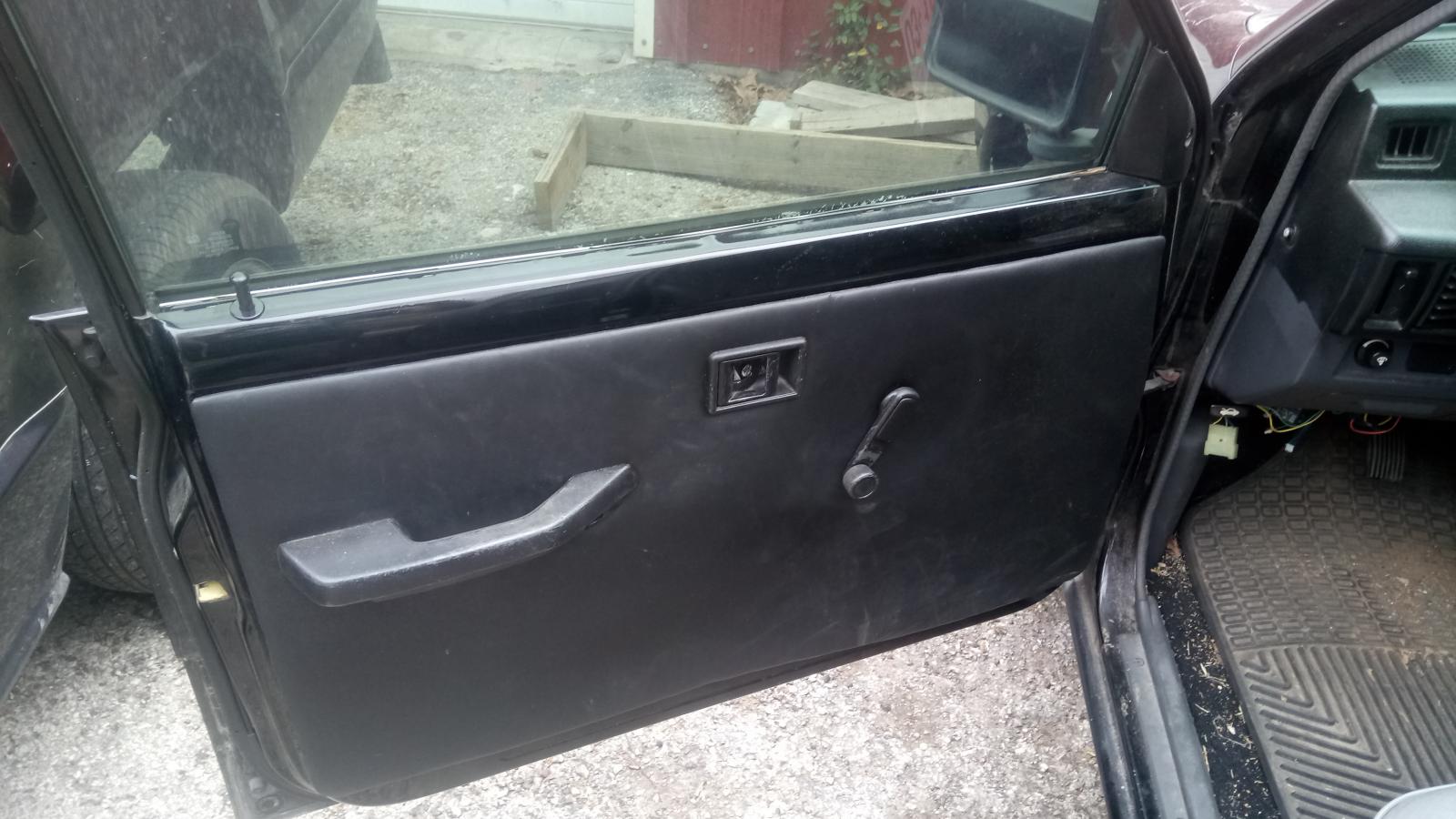

    The interior was altered, painted all black and dark. Windows got a tint also. Needs some more fine tuning and such but I say it still looks nice.
    The door panels have been taken out to install the auto lock/un-lock. The panels got done with a black cloth of sorts. The space from the window to the start of the solid part of the panel got cleaned up and left "blank". I say it looks nicer without the cover of fabric or other something material on there.
    The last picture I may also do with my single cab. I like the doors better that way, maybe I will also add a item holder to the front of the door when I do that for ice scraper of other things that I used to have in the doors.
