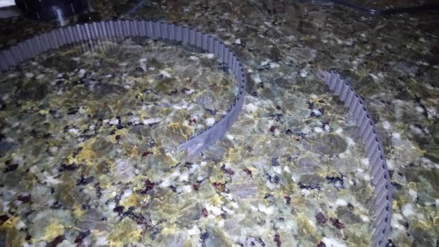

    I found the cause the engine stopped running. The cause here does not really worry me, lucky engine for being none interference.
    The reason for it "snapping" the way it did though has me far more worried.
    Not fully confirmed yet but I think somehow the oil pump seized up. Belt got stuck and well. Snapped there as the crank is wwwaaaayyyy stronger in pulling then the pump is in stopping, are the closely matched. Well.
    The timing belt becomes the weak link in that and then you most likely get something like this.
    Timing belt is only about 8000 miles young and the oil was replaced about 500 miles ago. Had something odd at that time already.
    Work taking up too much time and the neighbourhood thinks that having an outdoor dog here is a crime....
    Wife car still needs a radiator flush and I have 2 extra cars in the unfinished drive way.
    1 day needs 50 hours. 1~10 for work, 8 for sleep and the rest for ones self!!
    Picture of the timing belt after the facts.

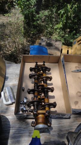

    Here something a little better, one content kitty. one of the many we have running around the house here.
    But not for something more "on topic" Macro cab.
    I finally got time and puff to do something. Texas heat it limiting me a lot though, working out in the back yard at 100+ heat, I would rather work in the snow for I am from way further North then this. Macro had issues of running and driving but almost no power. Lots of possible causes here. Pulled the exhaust, that went rather easy for it probably never having been taken appart since build some 30 years ago.
    Some stripped bolts and nuts made putting it back together take a little longer.
    CAT plugged with carbon build up. Ok, found at least 1 cause of low power and not I also have to search for what cause it to plug up in the first place.
    I did all this work in the course of several days. The next morning I found oil on cylinder 4 exhaust valve stem. Well, new valve stem seals and while doing that I can clean the valve train.
    Sure need some cleaning, also checked the intake valves and put new gaskets on there to make sure there are not intake leaks. What a pain removing that 30 year old stuff.
    Here you can see the clean springs in front and the yet to be cleaned ones in the back along with the spring compressor tool ( or at least part of the tool ).
    And here, not enough space for all that I am doing at the same time. Fixing an A/C, working on the engine and who knows what else I was doing to make that mess of tools and parts.
    Time for the followers!
    Looky, all sping sparkling clean.
    Even got the valve cover mostly clean.
    A night shot of the work space, it got a little late.
    Seems I have not taken any pics yet of it all put back together.
    Engine started right up on first try but runs horribly rich. Test so far indicates likely the fuel pressure regulator. At curb idle it its in the high 40 PSIs where it should be around 38. The high pressure ( vacuum disconnected ) is around spec at 50 ish PSI.
    Ordered a new one and hopefully that will fix it. if it stays running rich I may have to revert back to the original injectors.
    Anyway, here is all the work done so far.
    New gaskets on all exhaust parts, new CAT and new O2 sensor
    New spark plugs ( Irridium ones ), wires where replaced a few years ago and so was the whole distributor.
    All cooling hoses replaced ( I had those randomly burst on my single cab, better safe then sorry I figure this time ).
    New fuel pump and gas tank gaskets ( single cab tank was full or rust when I did that one, Macro was completely clean though ). Still 30 years old can use some extra love and care.
    New fuel filter and injectors.
    All intake gaskets replaced.
    Hehe, I also got me new switch arms at the steering wheel to now have intermitend wipers. That was probably the most expensive part.
    So well, there you have it. Single cab is still taking me to work and back or other places. I wish Single her A/C was working though, Macro hers still works so hoping to have her back on the road very much sooner then later with this heat wave.
    Fushy.
