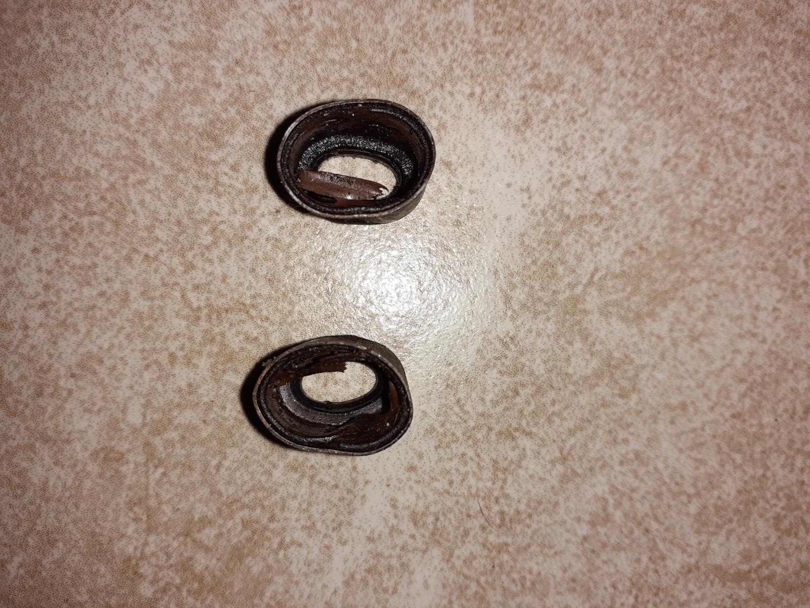

    Sorry for the late response I managed to get the seals changed 2 of the intake valves gave me alot of trouble but i finally got it this is what two the the old seals looked like20200516_085818.jpg but in the end thats why bbn it was smoking since i changed them inhave zero smoke now thanks for the help.

    end thats why it was smoking so bad since i changed them i have zero smoke now thanks for the help guys.

    1,261
    Thanks for letting us know! It's always great to hear a success story
