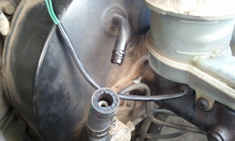

    Camoit, The harbor freight tool did not do it for me this time, haha. I think i might had used it incorrectly by not drilling deep/center enough so the extractor can settle down in more to catch. I just used a hammer and a flat head screw driver to remove the extractor. Once the extractor was removed, I then started to drill deeper, to only realize that a helicoil/time-sert kit will only cost as much as a intake manifold that i remove the carburetor from. Went back to PickNpull and it was still there in the engine bay. $25.99($4 core charge)
    When removing the manifold , I accidently broke the brake booster check valve. The stealership wants $25.19 for it, damn!

    I removed the intake manifold and notice the starter was missing a bolt. 14mm(don't know the lenght) also my starter wire keeps coming off.

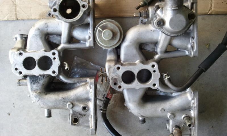

    So PicknPull is having a half off sale for members only. I end up buying another carburetor from a overheated 88 truck in the yard. Brought it home and slapped it on my truck only to find out the jets are clogged, so it won't rev pass 2000 rpm. I disassemble the carb to check to see if the jets are clogged and they were. When i removed the float i notice that it has a float over flow ball. I then took a quick look at the other carb i bought and that's what it was missing. 2012-06-14 13.56.59.jpg
    Maybe that's why the float bowl gasket is leaking.
    I also end up breaking the thermo valve sensor again after i have perfectly silicon the nipples. 2012-04-30 10.06.40.jpg
    I took the over flow ball and retainer from the overheat carb and installed it in the first carb bought from PicknPull. Feeling good about this plm being solved. After installing the carb on the truck it still shows a minimal leak around the float bowl gasket where the fuel inlet area. Damn! What to do? Guess im going to use the over heat carb float bowl but not needle valve to try to cure the leak.
    The truck idles at 1000 rpm steady with the hybrid carb , I still haven't adjust the choke yet. Im more focus on the leak right now.

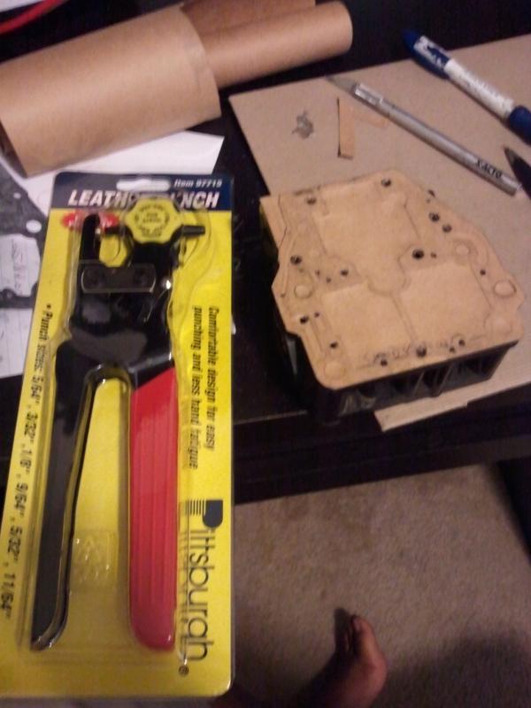

    The black gasket is the right float bowl gasket shape. So i went to harborfreight and bout a leather hole puncher , then to kragen to buy a gasket paper.
    It was a pita to cut out the gasket into the shape of the float bowl, but with a lot of patience and time it came out alright.
