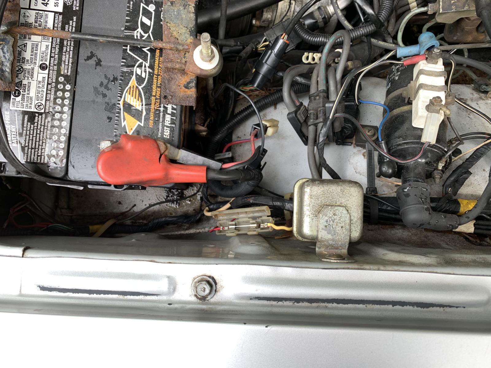

    There is an in-line fuse near the battery and i had changed that already but maybe the housing is toast? I can't really see what it goes to but it does connect to the wire bundle that holds my headlight wires near the headlight relay.IMG_4840.jpgIMG_4839.jpg
    I'm just not sure what else to check. Am I correct in thinking that as long as my relay is making clicks it's receiving signal from the switch in the cab?

    OK, so took the relay apart, hooked it up to my drill battery, and it seems to be working fine, cleaned up the contacts, threw it back in and no change. I think i must be missing a fuse or something somewhere. along the line. I'm getting all the other lights so i can't imagine it's a bad ground. anyone know of a secret fuse panel hidden somewhere? wheres the fuse for the headlights located?
    3,823
    Yea. It's not getting power on one side of it. Use a test light and work your way back.
    565
    If the relay clicks, that confirms the switch and relay are both working, and the wiring that triggers the relay is good, so the fault must be somewhere in the switched circuit that the relay triggers. I'll second Geezer's suggestion to check your relevant grounds on that circuit. Then check that you've got 12v to the hot side of the relay, then 12v coming out the other side of the relay when it's triggered, then 12v at the headlight(s).

    update: the girl has fixed herself. Which leads me to believe it must be/have been a bad ground. I've got to look around and clean up some contacts I guess.
