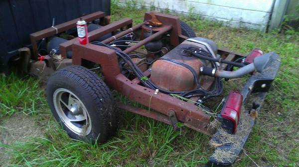

    Tank and bracket assembly cut out. They'll get rearranged /reworked and closer together . Need a good clean n paint

    Performed the surgery on the rear clip. Shoved some 2x4 between the leaf springs and frame to keep it from dropping all the way to the ground. This way it will still roll around and onto a trailer.

    With the rear frame rails removed it made plenty of room to get at the rear axle to grind off the rear bag perches.
