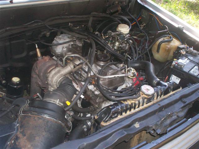

    100_0376 (Small).jpg100_0381 (Small).jpg100_0438 (Small).jpg100_0383 (Small).jpgYou guys can check the old board for the beginning of this thread. Ive got some new plans for upgrading the turbo to a big 16g td05h I just picked up. Some new paint should come along in the next few months. Ive had some new ball joints for a while now but havent put them in. I want to go ahead and replace all the bushings while I am at it since its squeaking. Hopefully some new coil springs as well...mine are saggy.
    The big 16g turbo fits without modification to your starion manifold? A lot of people on dsmtuners claim the evo 3 16g outflows the big 16g turbo. Just a little curious on your choice of upgrade.

    Slight modification for the turbo. I can either send out my starion turbine housing and have it machined to fit the 16g exhaust wheel ( which will let me keep my existing downpipe) or I can make a new downpipe and use the 16g turbine housing. The starion manifold has about the same bolt pattern. There are a few ways to go about it. I need to reclock the compressor housing so that it points the right way and do some mods to the oil/water cooler lines.
    Im not overly concerned about the flow rates. Not sure what the difference is. Its already a big upgrade for me since I only have a stock 12a on there now. I have already installed new injectors and a walbro 255 fuel pump. I picked up the turbo used and its an actual mitsu turbo...not some ebay stuff. A direct bolt on turbo would have been a lot more$$$. Trying to make big power with the g54b is much easier with mpi and before I go through all that I would just go 4g63 twin cam. There is a much larger aftermarket support and parts availability for the eclipse stuff. I have a 2.4 shortblock my buddy is trying to get me to put his turbo eclipse head on.
    I never really planned on a turbo truck.....just kinda happened. If you talk to enough gearhead mechanics you are bound to find a deal you cant pass up. Thats how I ended up with the starion engine.
