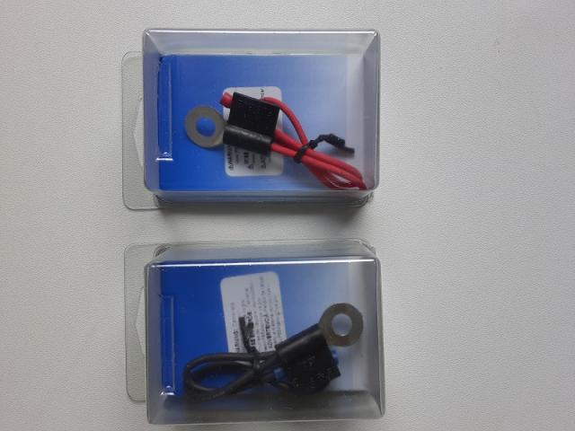

    Got these @ O'Reilly's today, gotta accumulate other connector & wire stuff for them to attach onto...
    one box says it's 1/4" eyelet & the other 5/16" but they look exactly the same to me 5/16" or bigger ~ at least the wire sizes look different ~ there is a 3rd fusible link under the hood for the alternator ~ will hunt for it someday ~ hope it's there & not just regular electric wire like what was coming off the battery...
