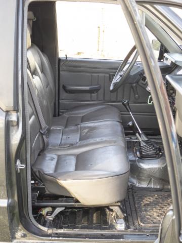

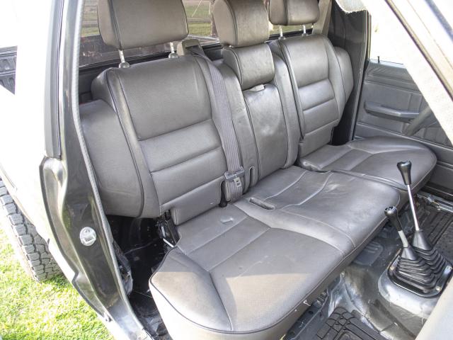

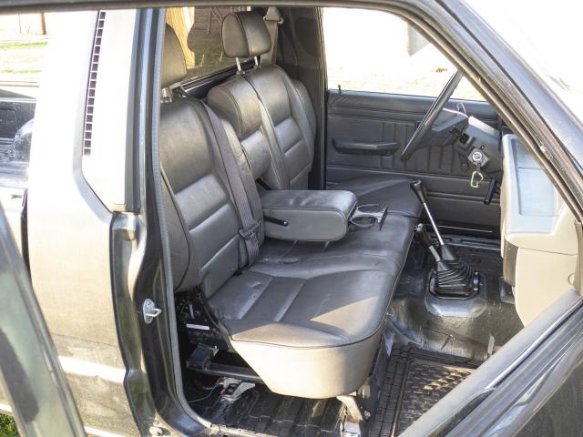

    I got tired of the damn torture device they call a bench seat and decided to make a little change, and I cant believe how well this turned out, and I wanted to share it with you all. This all happened somewhat accidentally, as I bought Montero Sport seats, which I didnt like enough to take the time to install. I disliked them so much I just tossed them in the trash. I realized the truck was designed around a bench seat, but all bench seats suck, right? NO!
    Enter the Land Rover Discovery rear passenger seat. Its mechanical. No motors. Perfect styling for adventure rigs such as ours, and since its a rear passenger seat, they see little use. I saw many Discovery seats that were 100% perfect and without wear, and still had the new car smell. Many were beige, and I didnt want that. I wanted pewter (grey) for the ultimate match.
    The Upside:
    • Its a bench seat.
    • The width is perfect, at 54".
    • Nice fake leather material.
    • Its a perfect design for the MM.
    • Great head rests.
    • It has an internal frame making it stand alone.

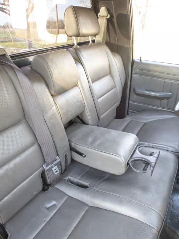

    • The center seat folds down and is an arm rest and drink holder.
    • Installation isnt too hard, as long as you have a angle grinder and a welder.
    • The seats have flat bottoms after you cut off all the mounting parts.
    What's the Downside?
    • There are wheel well cut outs, but I figure I can put tools there.
    • The seat does ride higher.
    • The forward and backward movement is limited, but can work better if you engineer a solution.
    • Its heavy, at 85 pounds or so.

    Actually a pretty genius idea. Love the food down center with cup holders!
    did you guys not get the 1/3rd/ 2/3rd benches like we did over here?
    in anycase that looks like a great swap! the colour even matches the rams door cards
    a spare seat for donor material and you could make "bolsters" to fill those gaps no problems

    looks oem.... well done

    Right, this whole thing looks the way the MM should have looked, and not with that thing thats barely a seat. If anyone wants to do this swap, Ill give more details.
    The install is simple, you use the original seat rails, and weld two 46" rectangular steel tubes to support the seat. I welded the seat to the support tubes.
    that...looks...AWESOME. The cut outs for the wheel wells are a little distracting, but with the end result you could live with that easily. Did you take the seat belt retractors and buckles from the donor so you don't have to monkey around with the belts?

    Does the back tilt forward for access behind the seats? If not, at least the wheel well cutouts help with that somewhat.

    Yes! That seat tilts fully forward in two parts, the driver seat and the center and passenger seat together.

    Its time for an update on this mod, we'll call it the '2000 mile test'.
    1. It's a generally comfortable seat. Its firm, and that might make some complain that it isn't spongy enough. For me its perfect.
    2. The double sided drink holder is great, and a welcome modernization of the truck. The drinks sit in such a way that they don't interfere with shifting.
    3. The arm rest creates a straight line from the bottom of your right arm, right to the shifter, and seems that the arm rest was designed to match the drivers arm and allow best posture when shifting.
    4. Its a heavier seat, and somewhat reduces interior noise, maybe because its more dense.
    5. You sit higher, maybe because you're used to that broken down bench seat, and you sit so low. This is a bit of a surprise.
    6. The material is very washable.
    7. The head rests sit a bit aft, but its still an acceptable position.
    8. both sides of the seat still pivot forward giving you access to the behind the seat area, for tool boxes, etc.

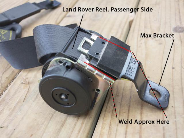

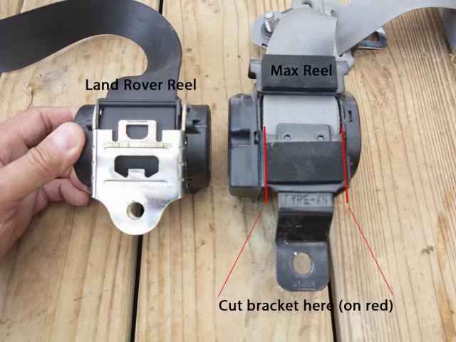

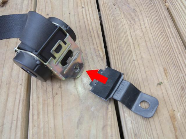

    Lets take a look at the seat belt situation, where cutting and welding was required to make the reels work. All of the Land Rover to Mitsubishi bolts fit perfectly. Maybe there is another way to do this, but I dont know of one. Pictures will explain this better:

    514

    Honestly, I didnt look that close at that option. It looked to me like the reels with swapped housings wouldnt match at all, and most probably the guts would be included with that. I just imagined opening them up and having springs and parts exploding all over the shop.
    Cutting and welding those brackets 'seemed' a shorter path.
    ...wonder if you could simply swap the clock mechs over from the different retractor carriers without butchering them
    Pretty sure they are not made to come apart again, and if theres an explosive charge in there id suggest squinting pretty tight, its built into the spring i believe.
    I think the best option is either a bracket adaptor made from beefy material, or modifiy the truck. Over here you would use some 3mm doubler plates about 50mmx50mm welded in to the sheet metal
