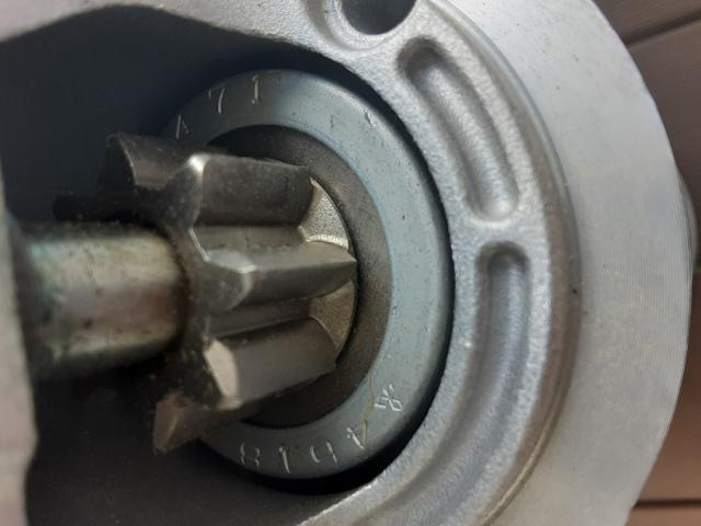

    Thanks for the question geezer man ~ this auction starter has 8 teeth on it's gear but I don't know it's diameter or if it will mesh properly ~ interestingly NAPA & OReilly's sell 8 teeth type but other web sites list our starters with 9 teeth ~ this is gonna be EXPERIMENTAL
    8 tooth throw out 'should' be the one for manual transmission. Mitsubishi made it confusing with starter motor and ring gear combos...

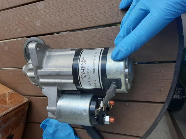

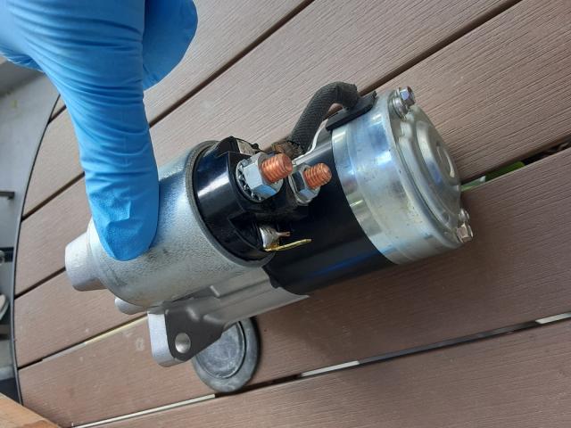

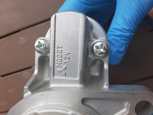

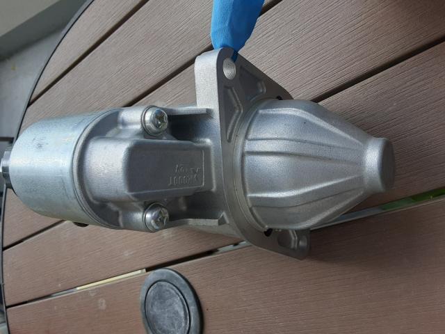

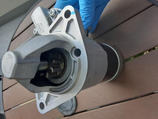

    Got Mail today ~ the GSA Auctions Starter Motor arrived today ~ looks new & unused (+) has Mitsubishi symbols (+ or -) could be China knock off ~ the CW 8 teeth pinion same as oem part (+) don't know if it will fit though (-) experiment project winning bid $35.00 shipping $70.00 ~ weighs about 7lbs looks smaller than whats on the truck ~ gotta comparison measure next (doubt any oem starters on the island NAPA no O'Reilly's no) will need to glean dimensions from the internet BUT I have learned & notice that specification data for the same part is often different depending on the store webpage

    that starter should fit. i have compared the large case starter that goes on the Manuel with the small body case for the auto and they mount up the same and have the same gear and everything. if your truck is Manuel it will have the larger body starter on it. i have both laying around. i can take pics if you are curious. also, if you are looking for cheep starters and cant find one for the mighty max you can use hyundia part # 00228-Y9100. those starters work too.

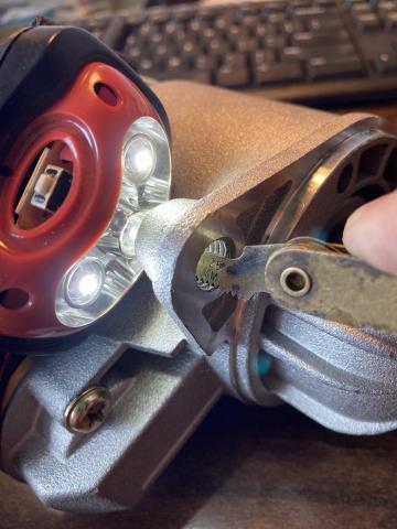

    Oh Oh ?? The two mounting holes are not threaded on this forklift starter need check my truck asap

    Thanks for posting fighter ~ I did not look at my truck's starter today BUT this new farm equipment/forklift/implement PMGR starter has no threads in the two mounting holes & I'm thinking threads are needed ~ gotta peek at the situation soon BUT today I was occupied getting the #2 Moderna covid vaccination @ the VA Hospital in Honolulu ~ Left arm getting sore tonight just like the Right arm did on #1 jab & overall day 2 and 3 have a feeling of fatigue 'n a little feeling of soreness all over ~ no biggie yet ~ funny musta hit a nerve on the Right arm coz the injection hurt 'n burned going in BUT today the nurse jabbed & I did not feel a damn thing..! She said they use 25 gauge size needles which are the most common size for vaccinations ~ heck I know more about shots than starters (not really)

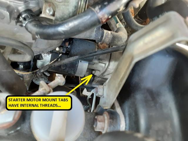

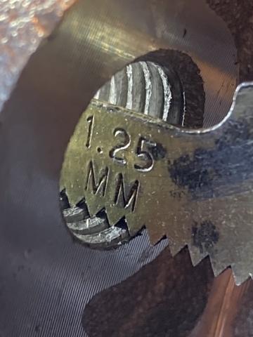

    Scoped out the existing starter on the truck today & it does have internal threads in the two mounting flanges ~ the tractor/forklift starter flanges are similar in thickness & drilled so they can be threaded too ~ no OEM starter on the island to compare on a workbench, might have to remove the existing starter to see if all else is samo samo besides the thread issue ~ ugh..! finalfighter do you have a stock starter with the threaded flanges & if so, maybe you'd be willing 'n able to do some measuring on it for me..? Check out the 2020 Ford Ranger truck compared to a gen1 Mitsubishi 4X4

    I think there might be enuff thread length sticking out on the mounting bolt that a thread pitch gauge might be capable of measuring those threads ~ I can check if Hardware Hawaii has a gauge, they are just across the street from me ~ trouble is can't get an eyeball very close to the starter while under the hood

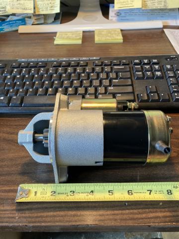

    Great timing on this xbox & thx finalfighter!

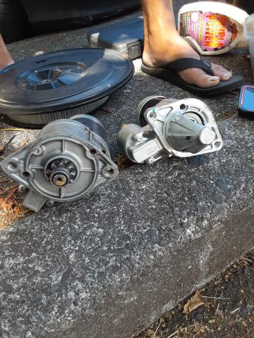

    I have been procrastinating on My starter replacement - pole type...
    So I went to my electrical builder and - "hey can I swap this starter for a pm style?,
    don't know if it will work but I will pay your time to find out, if it does work I will pay
    the difference in cost".
    Survey says
    M8 X1.25
    Builder compared drive, mount holes , nose cone depth, solenoid connections, all the same !!
    Differences--- about 26mm longer, 28mm or so narrower, and much lighter!!
    woo-hoo!!
    Update after installation,
    Thx again for the leg work Gents!!

    Hey THANK YOU for your leg work too claych 8 X 1.25 I'm still chicken to try it yet (truck starts good right now) but I wanna do this Mod too... Good Luck with your install ~ am very interested if the starter motor sound is like a jet engine spinning up compared to the ole big prop job un..? LOL
    New PMGR starter is in and working perfectly!
    Weird thing -- this starter is 'quiet' for 1.2kw with
    a gear reduction group --
    Now for the longevity test

    The auction starter was intended for farm equipment and fork lifts with Mitsubishi engines... He threaded the starter case holes to 10 x 1.25mm to match the existing bolts & even used a grinder to remove metal on it trying to make it fit... Best he could do was get only one of the original mounting bolts to line up... He said it would be necessary to remove a good amount of metal from the pointy end of the cast metal cover which holds the pinion gear shaft end bushing... Forget That...

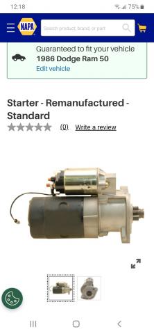

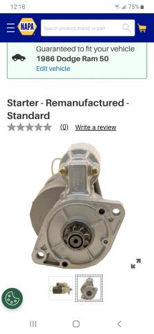

    So I phoned NAPA O'REILLY's AUTOZONE asked them if there was any difference between automatic transmission & manual transmission starters for my truck and they said no even though two types of starters are shown on Autozone & O'Reilly's web pages NAPA only shows one starter exactly like the one that was in my truck... They do require knowing engine size mine 2.6L (not sure what the starter might look like in a 2.0L engine) The starter like mine only fits 1985 & 1986 trucks... NOTE that the correct starter like mine has a white electrical wire coming out of the starter casing (not sure what this extra wire does but it connects to the truck wiring harness and it's clearly seen in the photo below)... The Autozone rep said the cone end shaped starter photo was a STOCK photo and not a photo of the actual part...
    Anyway long story short is the NAPA starter should fit it's the only one they list that fits a 1985 & 1986 2.6L engine irregardless of transmission type or 4WD & RWD ; while O'Reilly's & Autozone show two types of starters you better know whats in your truck before ordering a starter from any of them...
    MORE INFO: After reviewing RockAuto starter info it seems the transmission type does make a difference ~ the automatic transmission starter has the closed nose cone shape end 8 tooth pinion gear & the manual transmission starter is open face 9 teeth pinion and the extra white wire from the solenoid... Many of the manf have their starters listed as fitting the wrong transmission... Vernon tried to get the automatic transmission starter to fit my manual transmission truck without success... MitsubishiPartsCentral shows only the automatic transmission starter part# M085731D and I cannot find a Mitsubishi part# for the 1985/1986 manual transmission trucks...
