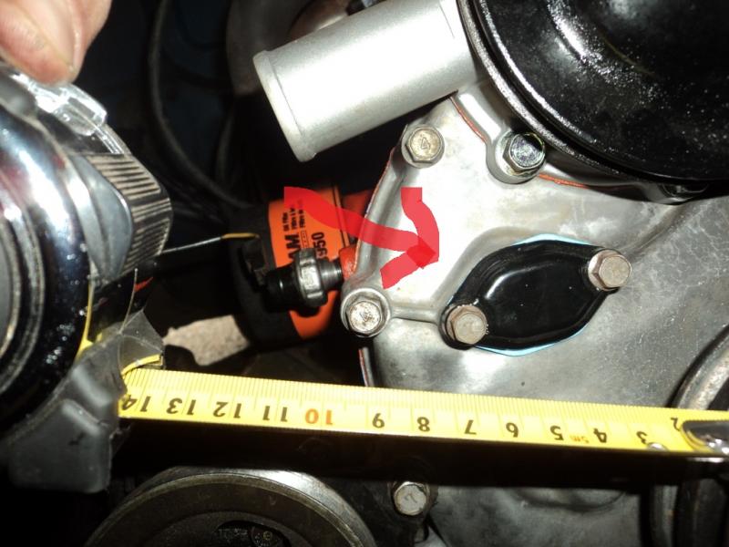

    you can tighten it up right here
    take off this little cover and there is a flange with a bolt through it. loosen the bolt and push the flange down (WITH YOUR FINGER, NOT A SCREWDRIVER) while rotating the motor over by hand. that should take up any slack. if you need to replace the chain, just take off the timing chain cover and replace it.

    Does anyone have the Mitzi part number for the gasket for this inspection cover? Autozone, Baxters, and NAPA drew a blank when I asked for one.
    Quote Originally Posted by PowerRam348 View Post
    Mitsubishi P/N 191430 Gasket, Timing Chain Case, Hole Cover
