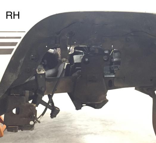

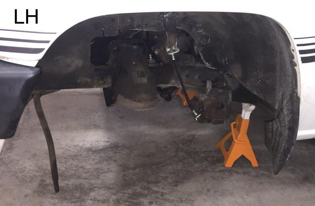

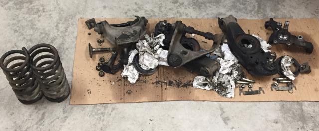

    Operation is a success so far!
    It took me 3 evenings to get all this stuff apart.
    A few difficulties but nothing major and no skinned knuckles!
    For decompressing the coil springs I just needed to lower the control arm with the floor jack and they dropped out of there with no drama.
    Also I’m pleased once again about parts availability. 32 year old truck and almost every part I needed was at the local O’Reilly at pretty reasonable prices. The free loaner tools were handy too! The only thing they didn’t have is the upper control arms. You can get those as complete assemblies from rock auto, with the ball joint & bushings, no need to get those things pressed in by a machine shop.
    Most excellent! And rewarding to have a crack at it yourself

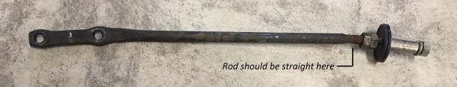

    Just ran into one more problem. My strut rod is bent!
    This is the drivers side strut rod:
    So I guess I should try to find a good one. Does this site have a parts diagram so I can find the part no.?
    If I can't find a replacement would anyone suggest if straightening it is a good idea or not?
    Doubt there would be a new one off the shelf. Only option is one from a JY. The problem with trying to straighten it is it will more than likely already be fatigued and heating/ bending it will only worsen the fatigue. If you were unlucky enough for it to snap at that point the end result would be disastrous...

    Job is pretty much done! And I didn't send my coil springs flying into the garage wall or anything. That was a relief. The truck used to pull to the right a bit when driving, now it pulls to the left. So at least I know I did affect something. It does seem to be less sloppy going over bumps now. Next step is alignment (which hopefully will straighten up the handling) and then new tires.
    Replaced: all ball joints, C/A bushings, tie rod ends, pitman arm, shocks, all rubber bushings, and the one strut rod pictured above which was bent. (Was pleased to find this at a junkyard in another state).

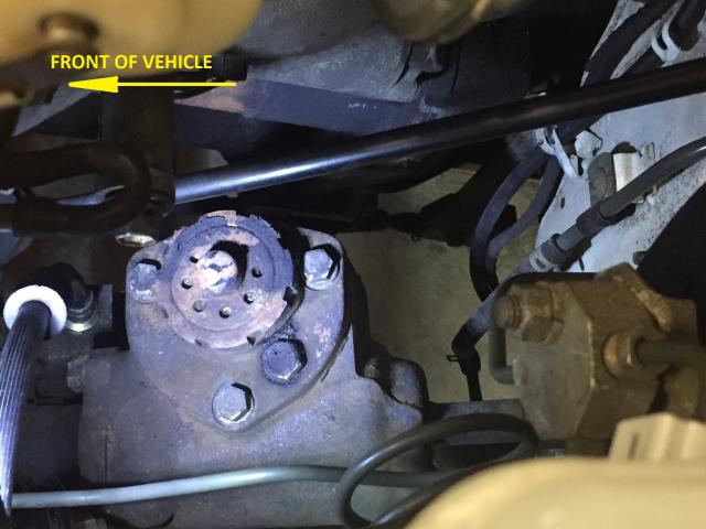

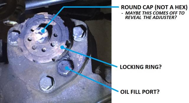

    One last thing I (maybe!) want to do is check & tighten the free play adjustment on the steering gear. Anyone done this? I have the haynes manual and the procedure looks pretty simple - but my steering gear doesn't quite look like what's in the manual.
    Here's the excerpt from the manual:
    But here's what my unit looks like: (manual steering, not power)
    So I don't know what to do. Or maybe it's better to leave it alone. Whatdayathink?
    Cheers
    charger_john
    I think you'll find that the steering is adjusted using a pin spanner/wrench and a lock ring wrench. My guess is the locking ring is backed off, then the centre lash adjuster is loaded up using a pin wrench and locked back into place with the locking ring. If I'm wrong and it's simply a dust cap over the adjuster, you'll know by giving it a clean and looking for a tell tale gap around the base of it.
