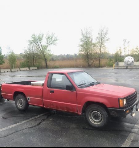

    Hey guys I just got a Dodge ram D-50 looking for some ideas ok restoring it. It’s factory red and she has normal rot on bed doors and bumper. I have a brand new black bumper but would like to restore as I call her the red rocket. Should I keep my bench seat? Change over to bucket seats? Should I kept her red or maybe go black. Tranny and engine rebuilt and she runs like a dream now it’s more Cosmetic any ideas I greatly appreciate

    Here she is
    A seat swap is worth while. If you are only likely to ever need to carry one passenger then a pair of decent buckets are the way to go. They were an option so finding a pair will save you headaches in mounting them but even adding seats from some other car/truck is relatively easy. Everything else - hey, its YOUR truck so go as crazy as you want! Roll over bar in the tray, spotlights, bash bar... whatever is your gig.
