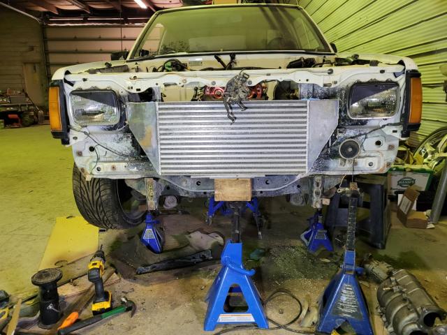

    Removed the original wide block 2.4. Positioned the narrow block 2.4 with the gm 4L80 trans bolted to it using Hinchers setup. Made my motor mounts to move the motor forward. Installed new cams and rockers in the head along with a truck water pump. Went with the thermostat housing that comes straight out to the side. I have a new crank and rods to make it a 2.1 destroked engine which is the future plans of this block.
    The aluminum rad is what I had installed in the talon previously, it fits amazingly well with a new bracket. The sides of the bracket bolt to the factory rad mounts, the bottom of the new rad mount has tabs that the rad posts sit in with a layer of rubber between them, the top of the bracket has tabs that bolt down with rubber again on the top posts.
    The intercooler is what was in the talon too. Can't remember the exact dimensions on it but its 3.5" thick and fits behind the factory grill and bumper. The outlet ended up right below the battery tray and will be cut shorter yet, the inlet will be shortened once the turbo is in its new home. Ignore the headlights in the picture, the previous owner did those lol.
