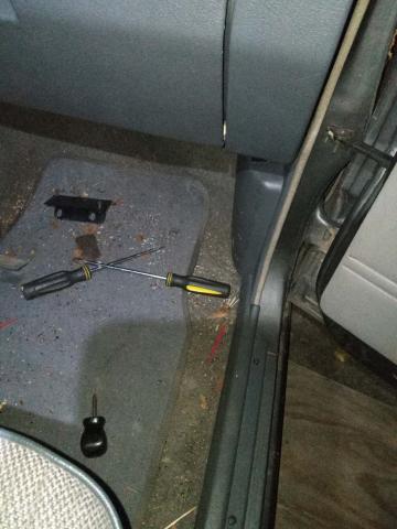

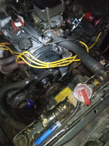

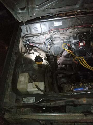

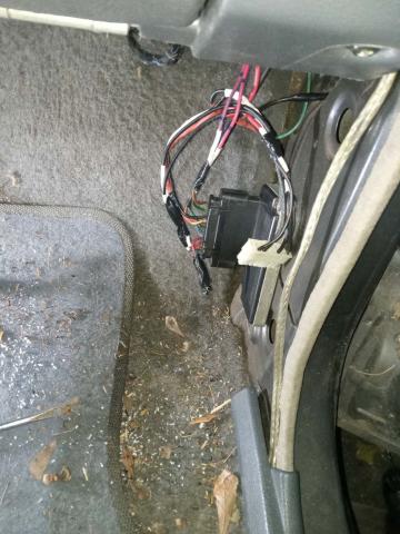

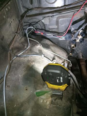

    The intake is next. Reinstalling edis/megajolt right now.
