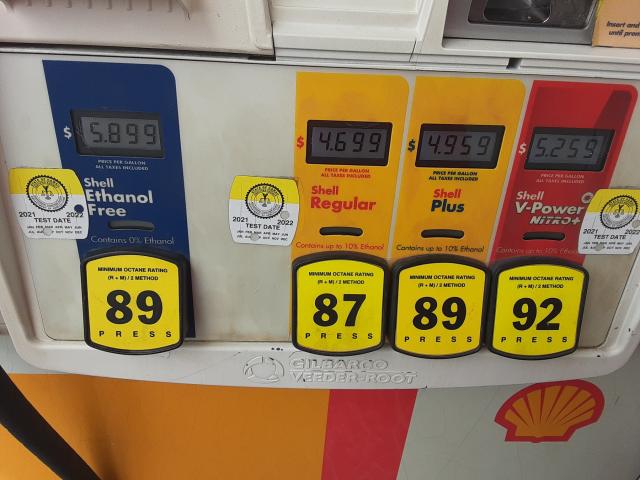

    Ethanol Gas might be affecting things..? I've read ethanol gums up the fuel system and causes rust inside the fuel tank, maybe..?
    https://www.bobvila.com/articles/how...gasoline-last/
    According to the U.S. Energy Information Administration, most gasoline sold in the U.S. is E10 gas made of 90 percent petroleum-based gas and 10 percent ethanol (ethyl alcohol). The shelf life of gas that is ethanol-blended is usually about 3 months maximum because ethanol oxidizes pretty quickly. Because ethanol is hydrophilic (aka, water-loving), it will also readily absorb any water or humidity in a sealed container resulting from condensation, causing both moisture contamination of the fuel and the eventual separation of the fuel into distinct gas and ethanol layers. Generally, the higher the ethanol content in the gas, the shorter its shelf life, so E15 (15 percent ethanol content), E20 (20 percent ethanol), or E85 (85 percent ethanol) gas will expire sooner than E10 gas will...
    I think there is a SHELL Station in Kaneohe town here that sells pure gas with zero ethanol ~ maybe I should run my tank empty then fill-up @ that Shell Sta at least twice..? Google can probably identify gas stations that sell ethanol free fuel..?
    I did two fill-ups of 92 octane gas, it made the truck run like SH_T then going back to 87 octane the problem went away..! LESSON Learned
