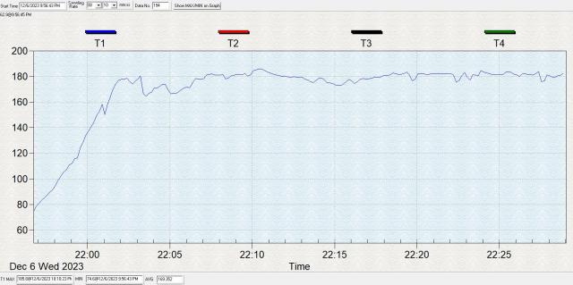

    For anyone bored, or curious, I found the "official" answer in the 4D55 Cooling System Shop Manual to be 82°C (180°F) to start opening and 95°C (203°F) for full opening with an 8mm gap. If i am staying under 203F, then the cooling system is in the controlled range, and the Tstat is still throttling the cooling system.
    The multi-vehicle encyclopedia that I bought for everything Mitsubishi made in the 80's and 90's had 190°F, but I never put anything that high in. The thermostat that I have in it now is 180F, and am monitoring temperatures. So far it is staying pretty consistent. I replaced the Tstat with extra holes in it so the motor will actually warm up in a reasonable timeframe of 5-6 minutes of driving instead of creeping up over 20 minutes.
    Since posting I talked with Mike Warme, who was an absolute WEALTH of knowledge. He recommended that I get the radiator professionally cleaned at a radiator shop, which I did. They had to clear the passages with rods as the boil didn't clear it out. I also changed out ALL of the radiator/heater hoses to avoid any rubber fines in the system.
    All that said, it should have a much better chance at staying cool and keeping a head gasket alive. I am still filtering the coolant, and the amount of iron/copper/rubber is still slowly dissipating. I am also using Peak Final Charge diesel coolant so that any possible cavitation is minimized from here on out. IDK if that is a problem with these motors, but it is a risk that i'm mitigating.

    Thanks for the feedback. I am not going to raise the boiling point much beyond the regular 50/50 coolant. The more I read and watch, having a boil over is not a bad way to get a warning that you have a problem. Of course, we should all see it on the gauge first, but we miss it sometimes.
    For the record, I am done drilling holes in the Tstat. It took forever to warm up, and didn't get there most of the time. It was only a little better than running no tstat at all. I went those routes in order to make sure that I didn't have any sort of overheating condition that cost me another head gasket. I am new to 4D55's and diesels altogether, so I approached it conservatively.
