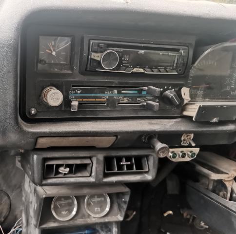

    08-03-2021
    20
    Australia
    1980 Mitsubishi L200
    Clock was common in Australia. I have two, neither work. Did a bit of searching for a mechanism to put in one but didn't get anywhere
