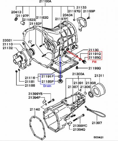

    I confirmed that I am wrenching on the correct bolt from a shop manual sketch (attached). I will try a 1/2" drive breaker bar with an extension like Chargerx3 suggested. I want to avoid breaking anything, so that was the main reason I asked.

    Thanks @xboxrox, ChargerX2, and FMS88. I got it off with a tight 6 point 3/8" drive breaker bar. It was just about a 1 armed dead lift pulling on the handle, but it went.
