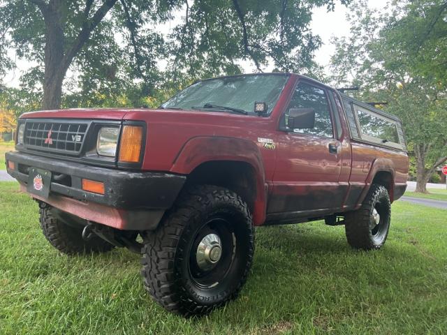

    Hey y'all!
    Just bought my first Mighty Max off a buddy. I'm told it's a relatively rare one since it has the 3.0 V6 in it! My buddy did a lot of work on it while he had it. He replaced a bunch of seals to fix up the oil leaks, replaced the valve seats, did the timing components and water pump as well as a few other things I'm probably forgetting. Unfortunately it currently has an intermittent misfire, and he just didn't have the time to work on it anymore so I picked it up for a good deal! Got new plugs and wires on order. I'm hoping it will fix the misfire, but if it doesn't where would you fine folks recommend I look next? Happy to see an active community around these old trucks!

    Glad I clicked on the photo link COOL LOOKING TRUCK love the chrome hub caps then tires look bigger than stock .
