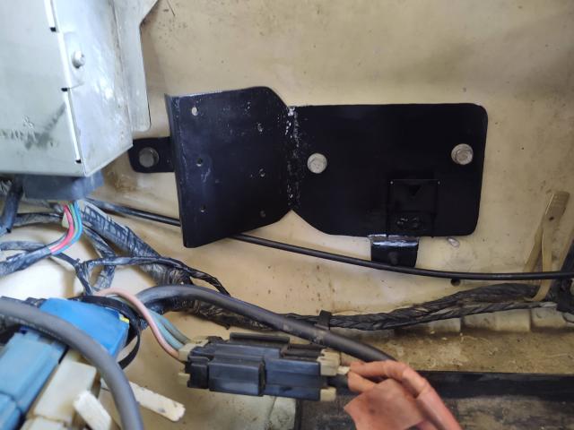

    I hate doing mods that alter the body permanently on my vehicles, so I like to make brackets that utilize existing mounting points instead, plus it gave me an excuse to use my new welder I got that's just been sitting! So I made this bracket!
    Note the mounting tab for the relay box, my relay box came with the mounting bracket from the car it came from so just drilled out the spot welds and saved it for my trucks bracket. I'm sure one could be made using a piece of strap steel the right with and thickness and drilling a hole in the right spot and filing it into a "D" shape so the plastic locking tab will lock it into place
    I made the bracket angled to keep the power feed for the fuse holder out and away from anything that could chafe the wires before they could reach the fuses! Here's what it looks like with the parts installed:
