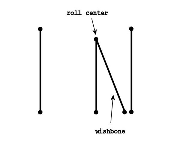

A different type of link system that falls into the three- and four-link group is the wishbone three-link. It is basically a triangulated four-link in which the triangulated bars are joined together to form a single point. Technically, however, it is still a three-link. The advantages over a traditional triangulated four-link are that the wishbone can be built much narrower and it can be oddly shaped to fit into seemingly impossible confines, with comparable lateral control.

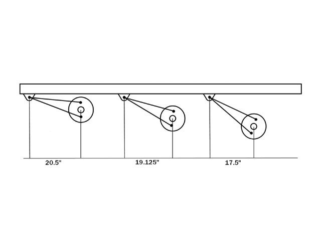

Chevy did build trucks in the '60s and '70s with a two-link that worked (NASCAR rear suspensions are based on this design), but it was engineered/designed to do so. You see, the "truck trailing arm" two-link has the forward frame mounts right next to each other with only enough room for a drive shaft to fit in between. These narrow mounting points allow the rear end to move more with just bushing flex alone, and on top of that the bars are actually engineered to allow some twist. This gives the design limited articulation. So, to properly set up a two-link that offers the articulation desirable in a street application, you'd have to take into consideration the design attributes of the Chevy truck system, which aren't easy to recreate.
Two-links installed on today's trucks are not as capable as GM's version. The traditional two-link also has travel limitations because of pinion-angle issues. Theoretically, the rear end should not rotate as it runs through its travel (it is necessary for it to, in order to have an instant center, but only a small amount), and a two-link forces it to rotate around a single point set by the length of the links themselves. This is not a big issue if the bars are long enough with a limited amount of travel, but it's a weakness just the same. The major issue is its inability to articulate.

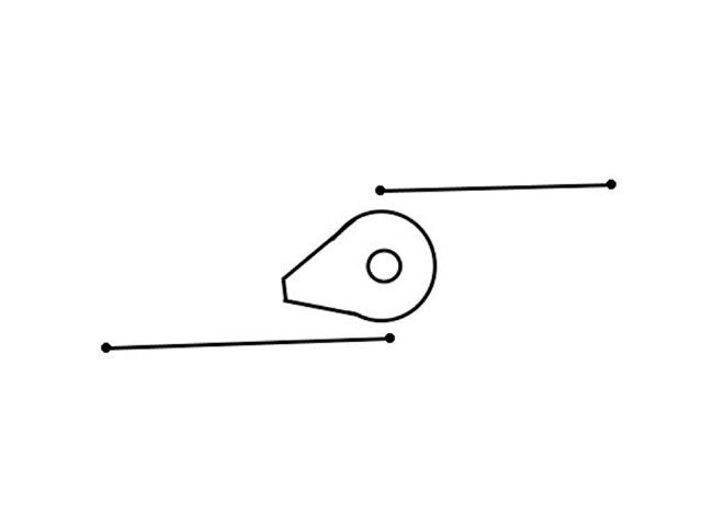

For simplicity's sake, we used a ladder bar in the roll-steer diagram on p. 107. Look closely and you'll notice that as the suspension cycles though its travel, the rear end housing rotates around the single front pivot point. As the suspension travels up it rotates forward, and as it travels down it rotates back. You can begin to understand how having one wheel up and one wheel down can be an issue. Essentially, on a two-link/ladder-bar system, the rear end housing acts as an anti-sway bar-a really big anti-sway bar-and that is not desirable for good handling or even daily driving.

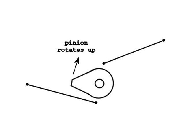

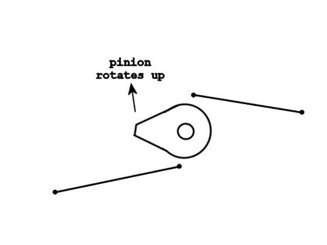

On paper, this design looks great because the pinion can be kept well within working limits. A quite desirable instant center can be calculated, and it seems to fit into the confines of just about any truck. The real negative effects are all dynamic, meaning that they are only noticeable when the truck is being driven and the more dynamics being applied, the less traction it has.
#2 0804st_03_z+rear_suspension_design+rotating_up.jpg #2 0804st_04_z+rear_suspension_design+pinion.jpg #2 0804st_05_z+rear_suspension_design+rotating_up.jpg
You can see from these diagrams that the pinion angle moves in a peculiar way (Figure 2). U-joints don't like the angles that are generated by a two-forward/two-reverse link system. It is possible to make the system work for a daily driver with zero performance advantages, but only with limited travel. On a two-forward/two-reverse system there are so many variables that can cause undesirable dynamic effects. The pinion is quite hard to keep within reasonable working limits, and the instant center moves around so much that there is no way for a normal human to track it, so calculating how forces are transmitted into the chassis is nearly impossible. It probably has more negatives than any other link design.

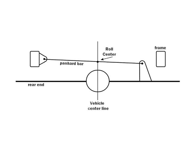

Panhard Bar
The simplest of all the locating devices is the Panhard bar. It is mounted to the chassis at one end and the rear end housing at the other. The roll center is where the Panhard bar crosses the center of the rear end. So the higher the Panhard bar is mounted in the chassis, the higher the roll center and vise versa. The weak link of the Panhard design is that the single bar pulls and pushes the rear end from side to side as it runs through its travel. The best way to battle the push/pull effect of the Panhard is to run as long of a bar as possible and to be sure that the bar is parallel to the ground at half travel.

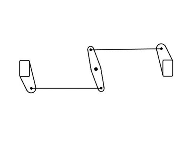

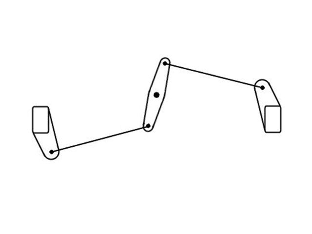

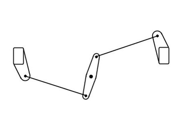

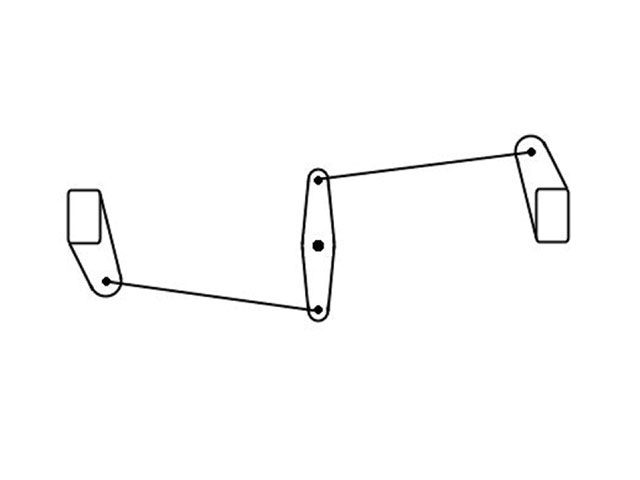

Watt's Link
The beauty of this system is that if properly set up, the Watt's link has zero lateral movement and the roll center is easy to calculate. The center pivot of the link itself is the roll center.
On a properly set-up Watt's link, both bars will be parallel to the ground at half travel, but the center link itself will be over center. The center link will be straight up and down only at 1/4 and 3/4 travel. Also, because there are two bars limiting movement, the links need only be half as strong as a Panhard bar. It's not unrealistic to be able to use a 7/16 rod end on the connecting links. The center pivot should be as stout as possible because it "sees" the entire lateral load at that one point.

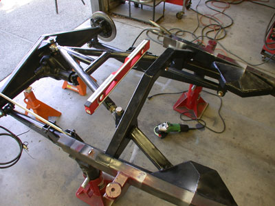

A track locator, or track bar, is typically used on drag cars because of its simplicity. A track bar is a bar that simply mounts to the rear link mount on one bar and the front link mount on the opposite bar, essentially creating a triangle that won't allow any lateral movement (Figure 6). The strange thing about the track bar is calculating the roll center. I have talked to some very knowledgeable suspension guys and cannot find a solid answer to demonstrate the best way to establish the roll center with this design.
By triangulating the upper, lower, or both sets of bars, you can limit lateral movement without the side pull of a Panhard bar. However, the bars must be triangulated as much as possible (up to 90 degrees to each other). It's tough to state a minimum angle because the length of the bars and the compliance of the bushings play a major role.

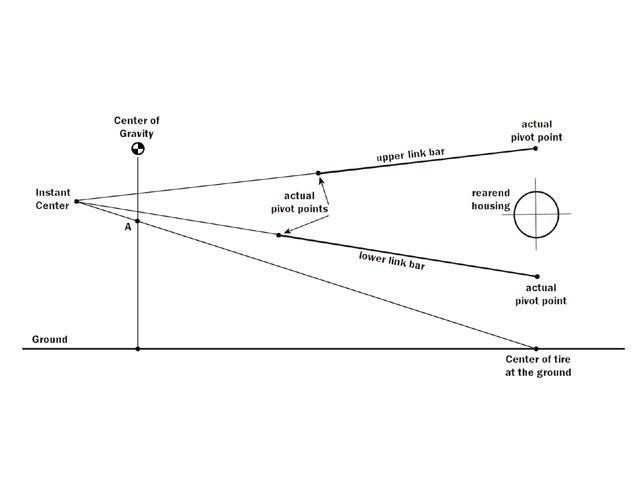

Any time two or more links, bars, arms, or any other types of locating devices are employed, there will be an instant center (IC). The IC is found by extending an imaginary line through the points of each individual locating device until they meet the imaginary line of another related locating device. The point at which they meet is called the instant center or instantaneous center. Take for example a simple four-link. From a side view, the four-link appears to have only two links. If you were to extend an imaginary line through the pivots of each individual bar, at some point those two lines will cross. The placement of the IC is what determines where the forces generated by the tire / rear end relationship will be transmitted to the chassis. By moving the IC forward or backward or up and down, you change what type of driving the suspension excels at. This is the most important theoretical point to understand in the world of suspension design.
A properly set-up three- or four-link will have an instant center that is somewhere in front of the rear end. By moving the IC front to rear, you change the amount of force applied to the chassis. By moving it up and down, you can dial in the desired amount of anti-squat. The position of the IC combined with bar length determines what it is that the link system excels at. A longer bar will allow more travel (but at the cost of energy transfer), while a shorter bar has less travel capability but more force transfer (think off-road truck versus a drag car.) Since most of you will probably be building a daily driver with adjustable ride height, the system should be somewhere in the middle. A medium-length bar with the IC around the front bumper at half travel is a very neutral system. It is essentially how Detroit has been doing it for years.
Also note point A point is a percentage of the center-of-gravity line (Figure 7). That percentage is the measure of anti-squat. When a truck accelerates, weight is transferred to the rear, making the suspension "squat" from the extra weight. This chassis movement can be minimized or completely eliminated by using geometry to negate the squatting effect. On any rear suspension system (assuming it is a full-forward system, even a two-link), moving the IC higher will produce a higher percentage of anti-squat, making the truck not squat as much during acceleration. A lower IC will have a lower percentage, and the truck will squat more. Going overboard and running the bars high in the front in order to negate any squat will induce excessive roll over steer, making the truck less stable while cornering. It is not so important to calculate anti-squat for a daily driver; it's more important you understand that it exists.

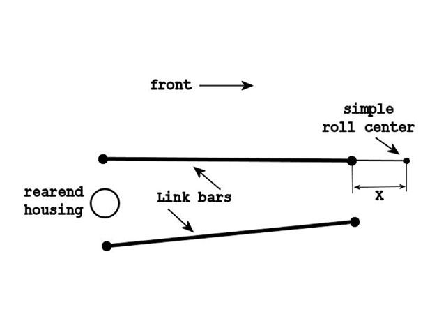

Every suspension design has a point at which the truck "rolls" around when leaning from side to side. A higher roll center (relative to the center of gravity) will make the truck lean less in a corner, and a lower roll center will lean more. You might at first think you need a high roll center in order to eliminate excess body roll so the truck handles better, but that's not necessarily the case. When the chassis leans to the outside while cornering, the leaning adds extra weight to the "loaded" outside tires, increasing traction. To have more weight transferred onto the "loaded" tires offers better cornering traction but at the cost of excess body roll (this is where anti-sway bars come into play.) Calculating roll center is not so important for a daily driver, but knowing it exists and understanding how it can be changed is helpful when designing a quality system or if you intend on speeding around corners in your sport truck.

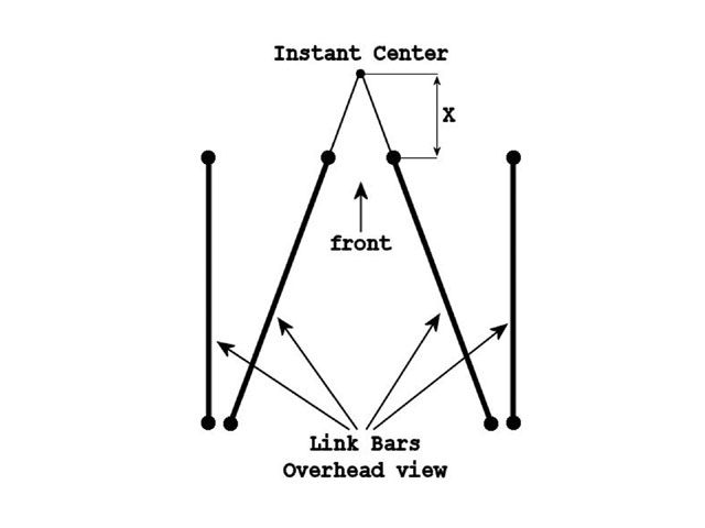

To find the "simple" roll center of a triangulated link system, you would first find the instant center of the overhead bars (Figure 10). Then, find the distance past the bars of the IC. From there, you would input that distance into the side view. That will give you a close enough roll center to figure from. From the side view (Figure 11), you can see that as the suspension runs through its travel, the roll center will move slightly up and down. That is not necessarily bad, just something to take note of.
From an overhead view, you can see that the roll center is or isn't centered to the chassis depending on the suspension design (Figure 11). And from a side view (which looks just like a non-triangulated link system), you can find the height (the single point of the wishbone.) An off-center roll center should be avoided if any performance is desired. Mounting the single point off center from the truck is not recommended because having an off-center roll center makes the chassis "think" that it's heavier on one side than the other. This can be interesting when driving aggressively on a windy road.
On a side note, a wishbone can take up a lot of extra space to properly set up on a truck designed to lay frame because of the need to mount the single point in the center of the chassis. As a rule, if the truck has a one-piece drive shaft, the system will take up more room than necessary.
