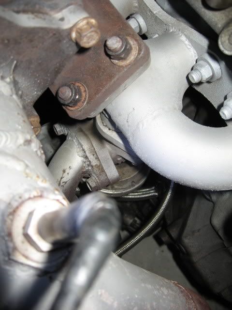

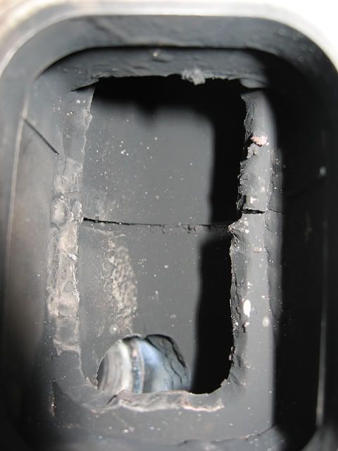

The next step is ebay manifolds. I can not say enough about these piles of shit. I have more patch welds on my manifold then a I ever care to think of. I've had my entire wastegate fall off the manifold, Twice. DO NOT EVER EVER EVER EVER think of getting an ebay manifold, Or any cheap manifold for that matter. You are only setting your self up for a lot of work down the road. They will crack, They will need repairs, They flow like shit. In fact, Here are some pictures of my lovely ebay manifold.
PILE O SHIT.
